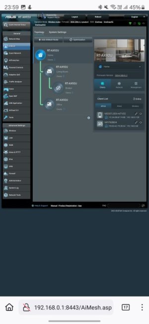

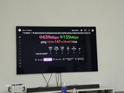

I have 4 RT-AX92U s setup as AIMesh... Wireless backhaul since ethernet is not an option here... Transfer Speeds to a PC I have (that's connected to one of the nodes through a 10GBe switch) is absymally slow...

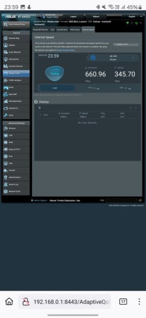

My internet connection speed is 700Mbps... On phones, connecting via 5Ghz I get about 200 (sometimes not even that.. like right now 25, though speed at the router is 700mbps - screenshot attached) and most times transfer Speeds to that PC are like 4-10MBps...

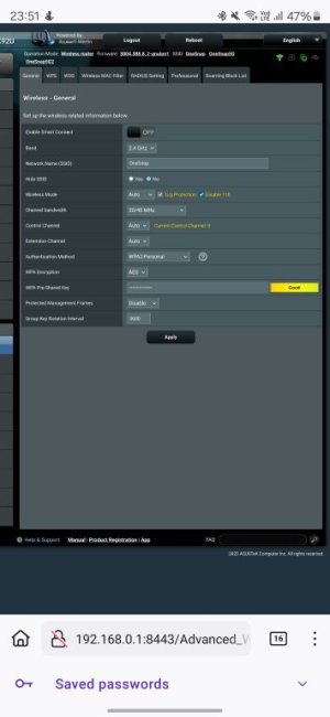

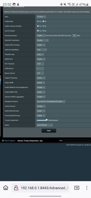

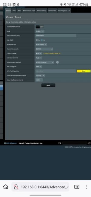

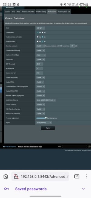

I've attached screenshots of my wireless settings... Can anyone advice what could be the issue?
Yes running custom merlin fork... But this was the same thing that happened on the official firmware to so was checking if merlin would fix it... It didn't :(

If you are measuring 26Mbps on this node, that can be the wireless losses between the main router and the "Living room" and then above that the added losses between the "Living room" and "Bedrom". Means that it is normal with wireless backhaul. Depending on how far they are from each other and what is between them. (Be aware that if you will share higher resolution images in the future, hide your SSID and MAC adresses)

This attachment is a pic of a Nvidia shield connected to another mesh router (via ethernet cable) and as you can see it gets full speed...

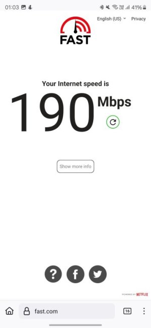

The main router and the living room node are 30feet apart with one wall inbetween... And right now I'm outside.... 30 feet in another direction and I'm getting 200mbps... And the transfer Speeds to that PC is 20MBps right now (first time I've seen it go over 14)

Its not visible on your pics, but do you have the latest firmware? Newer firmwares seems to handle the mix of 2,4GHz and 5GHz bachaul a lot better.

Yes I had the latest asus firmware... then I tried the merlin fork too...
