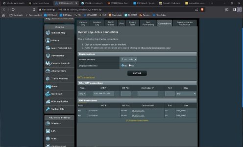

When i check my Systemlog > Connections, i see my Synology NAS with local IP 192.169.30.102:different ports connects to 34.210.61.151:80 which is an Amazon server. Ik don't know why, but i don't want it.
How can i prevent it? I've tried setting Firewall > Network Services Filter like this. But still it seems to connect, though connection state is TIME_WAIT most of the time. I have no need for extra apps like Skynet and hope it can be done directly in Merlin.

Remove the second rule as it doesn't do anything. You can leave the source ports field blank as that is the same as specifying "all" the ports.
34.210.61.151 is AWS so it's quite possible that it's actually a Synology-related server.
If you still have the problem post a screenshot of the connections page.
Have you looked at the Synology NAS configuration to see why, aka what DSM feature (ETA: or DSM package or docker container) you have enabled, that is connecting to an Amazon server? It may be possible to disable that feature to stop the traffic to the Amazon IP/server. For example have you enabled Synology Account in the Synology DSM? Have you enabled Synology's Active Insight? What about having DSM's QuickAccess or DDNS enabled?
Removed the second rule and cleared the port range field on the first one like Colin suggested.
Found out that it happens when streaming radio stations. I have Lyrion music server running as a Docker container on the NAS. Obviously i can't block all internet access to it, so i'll try to block specific sites (Amazon, Cloudflare etc.) which IMO have nothing to do with listening to any internet radio station. Also configured all radio streaming connections to run via WireGuard now. Had made some exceptions in VPN Director for Hi-Res stations (like Radio Paradise) in the past. Will see...

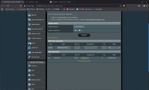

Well, this is how my Systemlog > Connections overview looks now. The only connection made is to a Worldstream server, which makes sense to me. Guess i'll leave it this way (no firewall), since Hi-Res streams are running fine too via Wireguard.
<edit> jumped too soon. Connection attempts to 34.210.61.151:80 are back, so i set up a Firewall > Netwok services filter rule.
Connection state is TIME_WAIT. Google came up with this:
  • TIME_WAIT indicates that local endpoint (this side) has closed the connection.
Does this mean the firewall rule kicks in, killing any attempt to connect?
