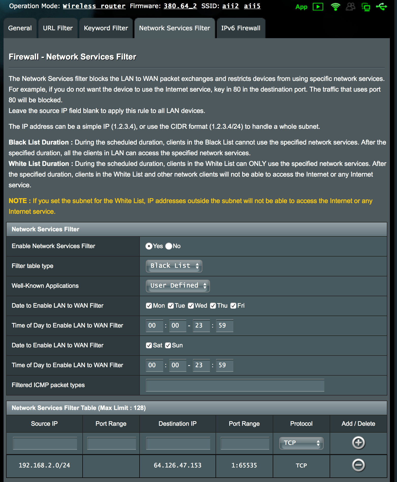

Yeah, I was messing around with things as I had seen another post from John about trying to reverse the source and destinations. Here's the updated rules output. Still able to get to the website though posted by the OP.

and with CIDR:
-A NSFW  -i br0 -o eth0  -p tcp -s 192.168.2.0/24 -d 64.126.47.153 --dport 1:65535 -j DROP
Gateway used to test from two different laptops is 192.168.2.1.
Please post a screenshot of your Firewall page. Based on these logs, the rules are properly generated, but there's no jump to the NSFW chain, as if it wasn't enabled.
