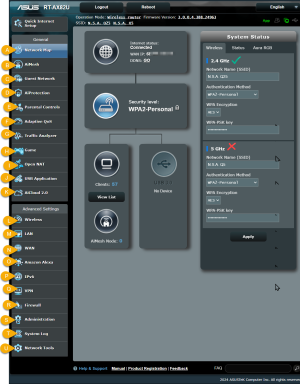

  • As of this writing, my 5Ghz SSID is not showing on my cell and the 5Ghz LED on the router is not lit, even though the dual-band broadcast is enabled. I can live without it but just wondering why?
  • The download speed of the 2.4Ghz band is low, between 4-12Mbs.
Attached is a screenshot of my router’s main GUI. Further screenshots or feedback of menu items A-U available upon request.
