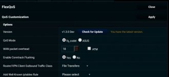

I was running 1.2.6 dev and updated thru the webgui. It did the update successfully but now it reads 1.3.0 dev.
This is not a big deal but thought I would mention it here. I fixed it by running "flexqos stable" thru ssh.

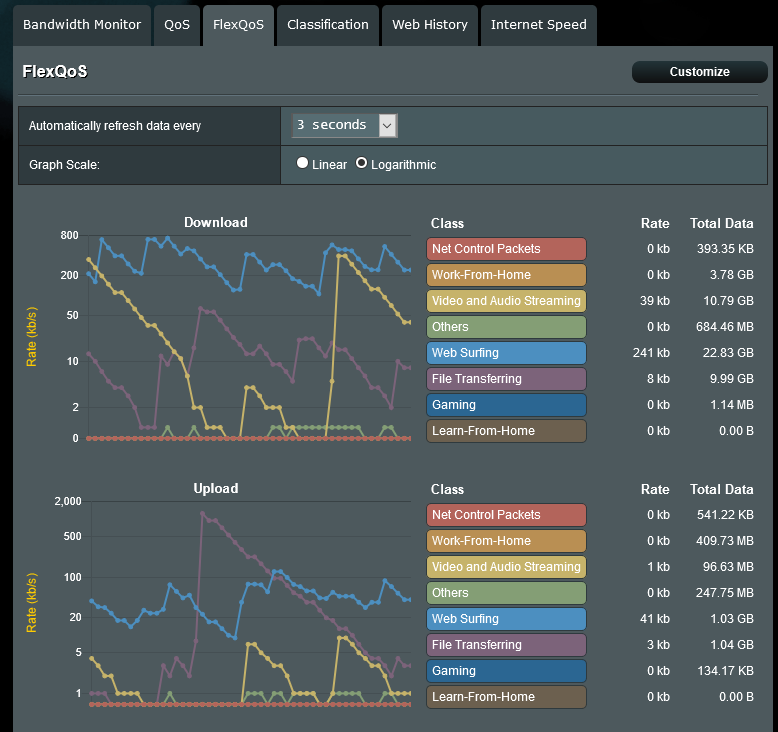

There is something wrong.
I have chaged class priority and now all videos stream are top!!
Change your category order around on the QOS page - not the FlexQOS page. Go with something like this: (You want Learn-From-Home at the bottom, in Brown.)
