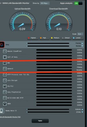

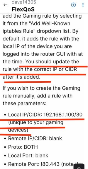

I installed version 1.4.5 through AMTM. And I did as it says on the post by @dave14305 - Gaming rule (Address from Sony PS5) 192.168.50.93/24 ,remote ip blank,proto BOTH,Local port BLANK,Remote port !80,443. 000000. I only play one Call of Duty game online. I have a static ip address so my ports in game are Internal 3074 and External 3074. With /24 I noticed that my TV also works on Gaming rule, Phones... Is it really necessary to put /24 at the end of the IP address for FlexQos to work!? In addition to the above, can I make another Gaming rule with these parameters: 192.168.50.93, remote ip blank, proto UDP, local port 3074, remote port 3074, 080056 (Call of duty) or 000000!? Or can only one Gaming rule be set to make FlexQos work?
Where did you read that you should use /24? That would be a mistake. For a single machine it should be /32 or none at all.
It says to enter the correct CIDR, which showed me from my Subnet Mask 255.255.255.0 that it is 24.
Another thing I noticed is that FlexQos doesn't load Gaming properly On the FlexQos control panel unless FC is turned off. Why is this happening!? Maybe in the next update, Flow Cache will be automatically turned off!?
Another interesting thing is that the router does not recognize the Call Of Duty app and switches to General.
That's why I asked my second question above which was not answered.
