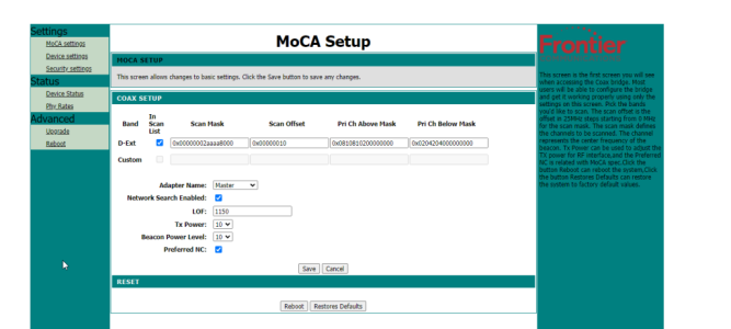

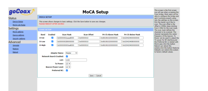

So after much troubleshooting, and many hours later, I believe I have found to be what the cause of my issues with the FCA252 adapters I had ordered from eBay. I came to the conclusion of these adapters being busted, and had ordered a pair of gocoax moca 2.5 which just came in yesterday, and they had solved my problem, so this eliminated all possibilities of my network, or a router setting, or the devices I were using. Well, I had noticed in the web configurator for the FCA 252 it only shows me D-EXT bands, but the gocoax show me 3, D-Ext, D-High, and D-low. Switching the gocoax to only have d-high brings back the issues I was having initially with my fca252's. I do plan on returning these FCA252's, as for my use case these are a paper weight, and I'm curious if anybody else's web portal looks like this.
And I'm not expert in MoCa, I'm only just learning so please forgive me. I'm not entirely sure if these 3 bands are necessary for MoCa 2.5.
EDIT: Just to clarify, I'm using the LAN band on the fca 252.

Oh, and I do want to clarify the *issues* I was having with the FCA 252's. First one was an insanely high latency on my Xbox, doing the built-in speed test I was getting almost 120ms ping higher than these GoCoaxs. Second of all, I was getting buffering streaming local movies but only on my android tv boxes, my xbox and pc worked fine on them. I stream the movies from my NAS, using SMB, and after turning off smb and going to NFS the issues went away. Something about the android tv, and SMB these FCA252 did not like. And if I did SMB streaming, over local ethernet with android tv, it worked fine, so clearly it was the adapters. And I even went as far to plug them straight into each other with a short half foot rg6 cable. Now, with the gocoax? I went back to SMB and it worked perfectly fine.

I posted in my second comment. Mainly for streaming movies from a NAS to a streaming player and light gaming. And yes there's no configuration you can do, I was just saying inside the web ui I only noticed D-EXT. Why are the other two bands not there that the gocoax has?
