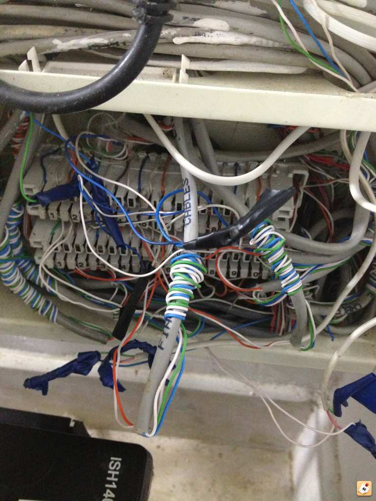

Yes I understand people are already cringing after reading that, I already read up a lot on the topic. Unfortunately my house has been built up and no CAT 5/6 cabling was put into the rooms and in completely out of question to draw the cat cable now.the other option I have is to use a wifi repeater but even the best linksys keeps hanging requiring frequent reboots. The only option I see is to use my existing telephone cable which contains 3 pairs orange blue and green. As I understand the tele cable is un shielded inside and is not a cat 5 class cable, not sure about how the twisted pairs are inside.
I believe I have three options to wire this
10 base T using two pairs
100 base TX using two pairs
100 base T4 using 4 pairs if I leave one pair empty
I understand even these standards are made to work on twisted pairs not telephone cable and even if I do get it to work high chances of cross talk leading to errors over time
Which among the three should I try 10 base T first or 100 TX , my download speeds don't exceed 8mbps but I would like to use this to connect An ip camera.
Distance is approx 15-25 meters
Suggestions welcome

You likely have no twisted pairs if it is telephone cable.
You might be able to do 10 or 100 Mbps over such a short distance only if the wiring is homerun, i.e. uninterrupted or tapped cable from jack to central point. Only way to know is to try.

Three pair provides no advantage over two.

Phone cables here in Sweden have been available in two styles: Pairs and 4-twist.
If you have white-blue, white-orange and white-green it is most likely twisted pairs. The twisting might not be the same as in CAT5 but I think you should be able to use two pairs for 100BaseT if your cables are not extremely long.
In our house I use a 20 pair phone cable from the basement to the attic (it was installed for phone use so when first extending the network 10 year ago I started using it for ethernet instead) and for 100BaseT it works like a charm. But then total cable length is not more than 30 meters (worst case, basement, to attic and back to other corner of basement).

It's a three pair orange green blue combo, will try it out and post results.

Thanks for the suggestions HVAC no don't have it, no false ceilings, getting a professional guy to come and do the crimping, he will look into feasibility of replacing the wire too as wiring is what he does . But I believe the pipe is no narrow and contains to many turns to be able to pull it out and replace it.
