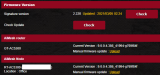

RT-AC5300 upstairs - wired backhaul to basement router
GT-AC5300 set to router mode and RT connected as mesh node. Firmware versions are now both Beta. I had updated and rolled back 2 versions with no change.
Some pics below. I can also post a router log but i am not sure anything shows a problem there either.

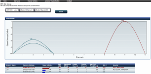

Maybe i am not an expert but this does not look right to me. When i do a test using the wifi radar tool in the GUI i get 2 signals shown for 2.4ghz both on Channel 2 and 1 for 5ghz on channel 42. This does not make any sense to me. The 5Ghz-2 is missing, and it should be on channel 157. And is the red line my wired backhaul? Should be the other way around on a tri band router, one 2.4 and 5 under 5Ghz???
Try running the scan using a PC/Mac application like the free version of Netspot. Worth checking if the 5GHz-2 radio is still marked as hidden.
The MAC address for the second wifi signal in channel 2 matches a Phorus device (wireless audio). Could be yours or from a neighbour.
haha you must really know your stuff. So you are right on the money here. This is my polk audio soundbar. I am installing netspot right now. No neighbors near me. I have 7acres and not a house within 1000' doubtful i will pickup much. Should be a good thing but still a struggle for wifi for the family. I am glad that i am anal and i name everything i add to my network. Took me along time with 65 devices but it really helps.
