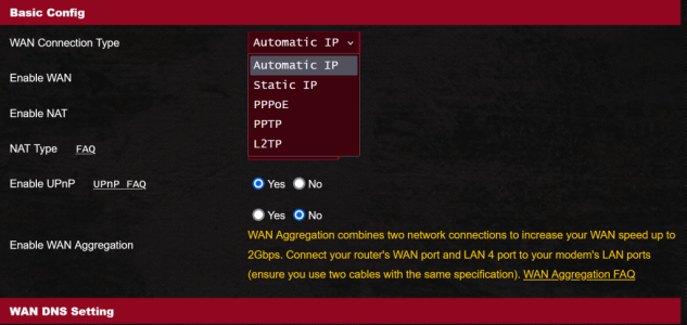

Google yielded no results nor did a search here. I just bought a ROG GT-AX11000 and I do not see the MTU setting. I'm assuming It is not available. Can someone confirm? Also if that's the case that stock firmware doesn't have it does Merlin add that as an adjustable option? Thanks.

i have the pro version flashed with merlin software but under the WAN tab on the most down portion of the page i saw this
is this wat you meant

It is but it doesn't matter as it won't apply when using auto instead of pppoe. I actually decided to flash it yesterday and tried this setting but seems unless your isp uses pppoe it takes no effect. I tried the rog and standard version of merlin and it was the same. My netduma xr500 has it, I expected the ax11000 to but I guess not. It's a shame as I need that flexibility for a game I play (apex legends) that flat out fragments packets or something unless I can lower MTU. So looks like I'll be returning the router.
