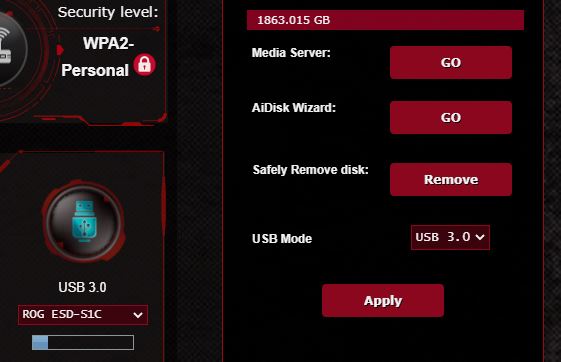

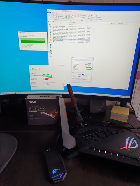

I have connected a Strix Arion enclosure with 2TB Kingston NV1 SSD x4 M.2 2280 to my Asus GT-AX6000 router using usb 3.0.
-I connected my computer to the router using CAT6 cable supplied with the router.
-In my PC, I have installed an ASUS PCE-C2500 2.5GBase-T PCIe network card and it shows 2.5 gbps connected speed in Windows.
-the PC cable is plugged in 2.5 gbps LAN port on the router, the one next to the Wan 2.5 gbps port.
- using the latest firmware on the GT-AX6000 router (3.0.0.4.386_48377) and Windows 10 21H2 up to date on my PC.
Whenever I copy files from usb 3.0 attached Strix Arion SSD to my PC (using samba share) I only get speeds up to 122 MB/s.
Why can't I get full 2.5 gbps transfer speed?
What am I missing here?

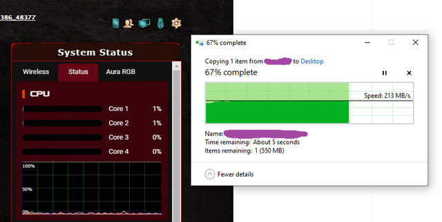

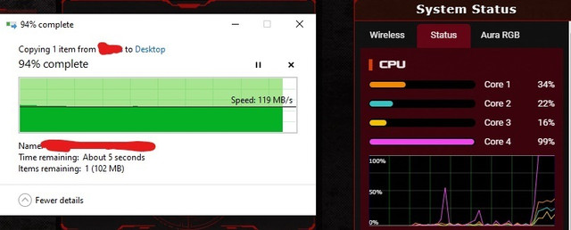

I have done another test and kept an eye on the CPU this time. Only one core reached 100%. The other 3 cores hovered around 20 - 35 %.
While I have not connected a 2.5G USB network adapter to the GT-AX6000, I did to the RT-AX86U and I only got 1G connectivity, so I would expect similar slowness from a USB drive connected to an ASUS router.
There you go. Samba is probably single-threaded, so it can only exploit one core.
If so, shouldn't the other 3 cores have stayed idle?
What is more, on my previous router,the AC56U (dual core cpu), transfering files over LAN stressed both cores to the max. Hence, I don't believe this is true.
Bad/ inefficient firmware optimization seems more plauzible to me so far, imho.

No, Dave is correct. Samba is single threaded so that becomes the bottleneck with one core at 100%. The other cores will be running other processes during the file transfer, mostly the switch code (bcmsw_rx) and some USB i/o.
You can see this for yourself by SSH'ing into the router and running top and then press 1 to show the individual core usage.
