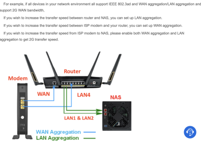

Link aggregation can be used on either the LAN or WAN side. (See screenshot from ASUS docs)
Yes (if supported). But they are configured in two different places in the GUI. Your original screen shot shows LAN aggregation, not WAN aggregation.
See the FAQ for WAN aggregation and the WAN > Internet Connection settings. If you don't see the option there then your router doesn't support it.
Ah, thanks. Very helpful. Looks like there's no option to configure WAN Aggregation on the GT-BE98 Pro. Hopefully they'll add it in a future firmware update.
