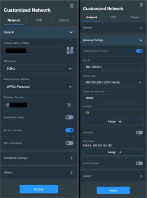

Tested using a mobile phone connected to a 5Ghz Guest Network to ping and connect via SMB to a NAS on the main LAN. Attached is the basic settings I'm using for that particular Guest Network Pro Customized Network. (PS: with Access Intranet temporarily enabled.)
