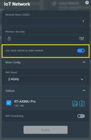

Does your Guest Network Pro entry have the option Use same subnet as main network enabled? If that option is enabled, the Guest Network Pro client on that preset will use an IP address from the main network's DHCP IP address pool. See attached example.

@routerq As explained above; when you enable Use same subnet as main network, the Guest Network Pro clients (on that GNP preset entry) will receive an IP address from the main LAN IP address pool. This means the Guest Network Pro client should be able to pull a manual IP address defined in the LAN > DHCP Server page.
As others have found out, the Guest Network Pro feature has some issues. For example when you enable Use same subnet as main network, the Access Intranet Guest Network Pro feature seems to be broken. Meaning the feature doesn't block Guest Network Pro clients from the main network if you disable the Access Intranet setting while Use same subnet as main network is enabled (at least it doesn't work on my RT-AX86U Pro).
Edit to add: This is what Asus says about the Use same subnet as main network option.
3. When setting up your IoT Network, the [Use same subnet as main network] option is enabled by default for seamless connectivity and easy device control. For enhanced security, disable this feature to create a dedicated IoT Network. This adds a layer of protection, ensuring your devices operate securely, providing peace of mind and robust network integrity.
*Enabling [Use same subnet as main network] restricts configuring DHCP server, LAN IP, subnet mask, VLAN ID, and DNS server.
