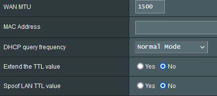

Have been on FiOS for quite a number of years and all of them with Merlin. Never had any issues with these settings:
But not every market is the same, and don't know if that also means different hardware on their side.
Yeah those settings have worked for me for years too but when going to 386 I was having WAN DHCP issues.

Stable on FIOS with DHCP query frequency set to Continuous
Morris
Have tried all 3 settings, unfortunately they all behave about the same. Every 1 day or so internet is totally blocked, have to disable and re-enable WAN to restore (at which point I get a new IP).
