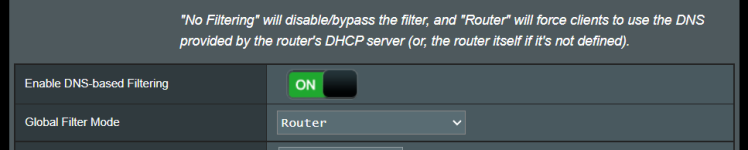

Thanks for the info, it's helping me a lot. The hosts.add and Prevent client auto DoH part has already been configured as explained by you. But I don't know how to do it in the dnsfilter part, could you explain how I configure it?
This:
