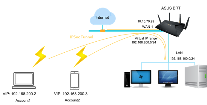

I'm wondering if anyone can show me how to route an IPSEC subnet back to my main LAN subnet so that I can access the SMB server when offsite.
I found an Asus FAQ with an image that is exactly what I'm after, but it's for BRT routers and not RT-AC5300 series, and so the GUI options shown don't exist in the AC5300.

The above is exactly what I'm wanting to do.
Main subnet/LAN: 192.168.1.0/24
Router IP: 192.168.1.254
SMB Service: 192.168.1.100.
IPSEC LAN: 192.168.120.0/24
The above is what I have now and I'm able to connect. routing exists for me to get to 192.168.1.254 and view the Asus admin GUI, but no other route exists for me to get to the SMB server.
