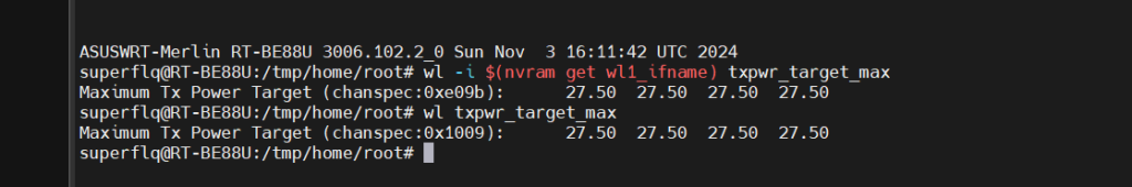

The first question is, no matter how I change the wireless coverage area and transmit power adjustment, the power queried in the router is 27.dBm. Is this a display error or the setting is not effective?
I used the following command to query, and the results were all 27.5dBm
wl -i $(nvram get wl0_ifname) txpwr_target_max
wl -i $(nvram get wl1_ifname) txpwr_target_max
wl txpwr_target_max
The second question is about Smart Connect. The current version does not have the setting of 5G falling back to 2.4G. Has it been removed now? As shown in the picture below
