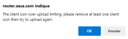

I have my devices listed under LAN->DHCP-> Manual assignments. I have about 30 devices with custom icons and names. I was adding a new device and an error popped saying I have too many icons. I clicked ok and a very nice window popped up with a column list that showed all of the MAC address and icons that were stored on the router and was able to delete some devices and my new device icon appeared as usual. My question is how do I get that pop up table to appear again? I removed a bunch of devices, but wanted to go through the list better to remove all devices not in use. Thanks!

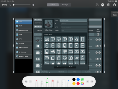

I’m guessing since the OP stated they were adding a device, they were in LAN DHCP Manual Assignments, so they were referring to this screen.
I’ve seen the list of default icons as pictured, and I used to add custom icons at one stage (there was even a post or two in the forum with additional icons) but I no longer do that. I’ve never seen the message about too many custom icons though.
The list twiglets is referring to is just what devices are currently online, not all of your static IPs, which is on that same Manual DHCP assignment page. If it’s not the list twiglets is referring to, nor the full DHCP list I’m not sure I’ve ever seen what you describe happen. Please take a screenshot if you see it again!
[EDIT]OK, so in one of the threads I linked to above there is one person who had a message pop up that sounds like yours. Does it look like the one in that message? No mention of what happened after they clicked it though.
The same thread has some URLs to various icon lists e.g. this one still works (you I’ll need your own router IP ago replace the 9). The follow on to that being, I’m guessing there must be a URL which links to or generates the table you’re referring to based on the message; but i haven’t seen it advertised anywhere.
