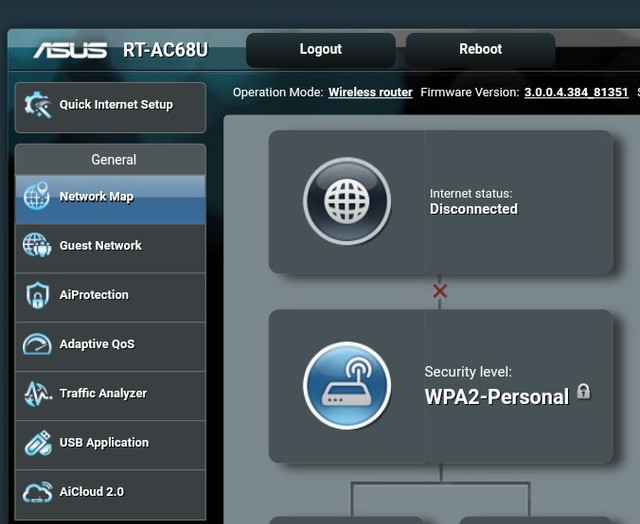

My Asus RT-AC68U has been up and running for several years but for two days something happend. In the router web interface the internet status is "Disconnected". The Internet WAN LED light is flashing. I´ve installed the latest firmware and also try the reset function but the problem is still there. Now I´m running with an old router and it´s works well, So, is my Asus router broken? Or is there something I can do to get the router up and running again?

The issue seems more like firmware having problem repporting the right status to the Led and network map page.
Try to klick the little grayed out icon up to the right. There it say connected. Its a bit of contradiction.

Now I have done som progress. I have tested all tips above with no success. But I saw that the MAC adress row was empty under Special requirement from ISP in WAN settings. So I use MAC clone button and now I have internet connection! I dont why the information has been removed but I suppose that the MAC adress should be filled in because it´s now working.
