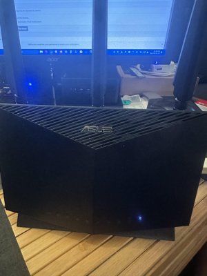

I purchased an Asus RT-AX86 Pro from Amazon AU on 3rd December. It has been working fine, and I had it set up as an AiMesh node. However, this morning, after 1 month of use, it stopped working.
I disconnected it and tried performing a hard reset using the reset button several times throughout the day, but without success. I also disconnected it from the mains in between attempts, but it still does nothing. The only LED that lights up is the white power LED, none of the others light up. I even tried the LED on/off button in case the lights were turned off, but that didn’t help either.
There haven’t been any power surges that I’m aware of, as the other two are working as they should. My NAS is also still running without issues. Unfortunately, I fear the router may have failed.

Hi thanks for your prompt reply. No nothing attached.
I will test with another power adaptor first. If that doesn't work. I will contact Amazon AU and see what they have to say.
Try a hard factory reset as a troubleshooting step if you haven't done so already.

Hi bennor, thanks for your reply.
I've just tried the method you suggested. Watched the video too. Unfortunately, the power light remains on. I held the WPS button for much longer than was shown in the video. I guess something is failed in the internals. I will try again later.

It is looking like a major failure.
Amazon do usually deal with returns of such quick failures very well.
Get in touch with Amazon ASAP and get the return started.

Update.. I did this morning. Yes you're right. Amazon AU accepted a return and have already given me a refund for AUD$333 the cost of the unit. I promptly bought another to replace it.
They have the RT-AX86 Pro for AUD$299 so a bonus, Its the cheapest I've seen it.
Their returns system was super efficient using the Parcel Point Drop Off. All in all a good outcome.
