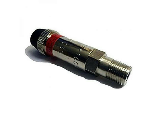

Looking for an affordable PoE filter that will ALSO provide an performance boost via reflecting back the moca signal.
Brand: BELDON PPC Moca (SNLP-1GCW)
This one is only $4 (CAD) free ship, but only supports the 1125-1525Mhz range vs say the Altronix GLF-1002

no i dont plan to have anymore Moca devices. So i assume the PoE filter ebay link i am considering (cuz its cheap) is fine: BELDON PPC Moca (model #: SNLP-1GCW) ? I noticed tho several here seem to favor the pricier Altronix GLF-1002. From a quick look at both specs it seemed both are similar with the GLF-1002 blocking at a higher moca frequencies (2005 Mhz) vs 1525Mhz for Beldon. Also, not sure if the Altronix one is better at stopping moca signal leaks vs the Beldon tho.
If no order has been placed, getting one explicitly spec'd for the whole of the MoCA Extended Band D frequency range would be preferable.(i.e. the Antronix GLF-1002)
As for blocking/attenuation of the MoCA signals, both appear to have the typical ~40 dB loss in the MoCA range. You could hunt for a 70 dB MoCA filter (e.g. Antronix GLF-1002B1), but 40 dB should be sufficient in your case, since any leaked signals would still face the attenuation of the drop amp before they could escape the premise.

Much appreciated for the detailed replies! I havent ordered anything yet so i guess i will go with one of the Antronix then :)
Curious, how exactly does the reflection thing work in these filters? Is it similar to say how when water wave hits a wall it reverberate back where the wave came from? In this case, since the filter only allows a smaller frequency range through (low-pass filter?) then i figure the other higher frequencies bounce backwards, and thus this reflections acts as a performance boost to moca devices?
Effectively, yes.
