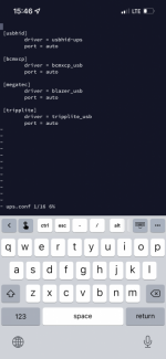

i was able to locate my ups.conf file, but its largely empty when i look in it using vi (screenshot).
would i add arguments like these to the file ?
override.battery.charge.low = 50
override.battery.runtime.low = 300
the device usbhid is my cyberpower ups as confirmed by upsd -l
