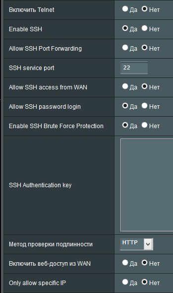

When I login web interface I saw 16 clients (usually 5-7). I began to update the value, and I had what I recorded on video (when the cursor approaches the topBanner, it freezes).

I went to shut off access to the administrator from the WAN

Settings:
How to fix it?
Or if you need SSH, enable brute force protection to prevent it from getting hammered, and potentially overloading your router.
Either disable SSH access from WAN, enable bruteforce protection or use SSH keys and this won't be a problem. I personally do all three :cool:
I need to setup a local area network via SSH,so it turned on for local clients.
Allow SSH access from WAN deny & Enable SSH Brute Force Protection turned on before this situation.
but how I then got 16 clients?
