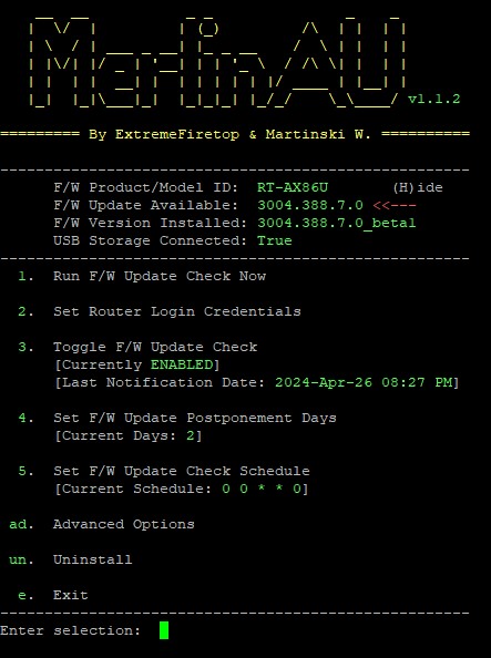

As I was updating the schedule, got this....
Though I do occsionally get this on the router and on either node, when launching the script even though automatic checks are enabled on all of them.
In this case it was the other node, (the one I manually updated, didn't get this message last night as I launched the script to manually launch the update) before answering "No", checked cron and the schedule was set. Then answered "No" and renabled it then updated the schedule.
Before schedule modification (on node)

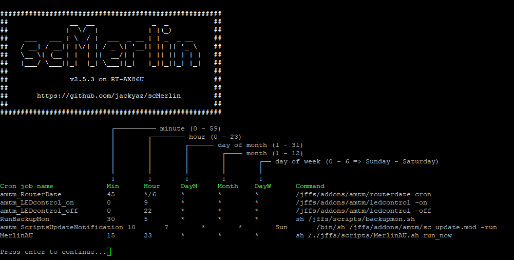

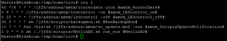

Your "Before schedule modification" screenshot shows that there was an error in the script path used by the cron job:
0 0 * * 0 sh /./jffs/scripts/MerlinAU.sh run_now #MerlinAU#
During startup, the shell script looks for its path in the scheduled cron job as follows:
sh /jffs/scripts/MerlinAU.sh run_now
Since the paths did not match, the code concludes that the cron job is not defined and prompts you to create the cron again.
After (on node)
The "After" screenshot shows the correct script path for the new scheduled cron job:
30 0 * * 0 sh /jffs/scripts/MerlinAU.sh run_now #MerlinAU#
So for some reason, the same code is creating the paths differently, which is odd.

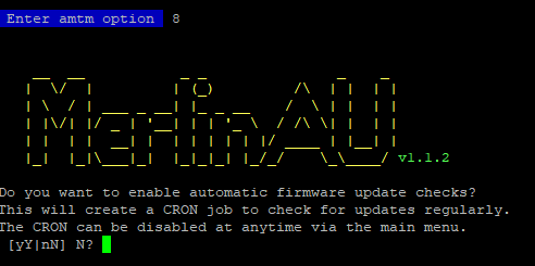

Script launched from AMTM / 8 everytime.
Manual was the update I did because the scheduled update didn't happen when I thought it would (my bad), MerlinAU / 1 / and "Y" if there's an update, before changing the schedule to have MerlinAU run nightly.
This has happened with the last few releases, but not consistently at every launch (odd), haven't had it happend with 1.1.2, but if it does I now kbow what to look for...
Can't even fathom what might have changed it. But going to try some of the scripts I've got on the nodes (to narrow it down). SCMerlin (via SSH), MerlinAU, BACKUPMON - short list. Come to think about it, SCMerlin does let you list cron jobs.
Node
The other Node - AHA!
And there it is, the extra /./ you mentioned, now as to what is triggering it? One of the 4 AMTM scripts, RouterDate, LEDcontrol_on, LEDcontrol_off or ScriptsUpdateNotification?
Same 4 run on the Router as well! Nodes pretty much stay hands off, so something running on them is doing it.
Launched MerlinAU on the offending node, and sure enough prompted to setup the automation. Re-enabled it, Cron job modified with the extra /./ removed.

That's entirely my fault :mad:. Reminder to self: Do not edit files on the company Laptop when on vacation and call it done - and then not sync back to development version when back home.
Fix will be out soon.
