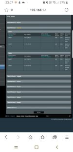

I used OpenVPN if I want to access my router remotely but am concerned in the OpenVPN entries in the log to see what appears to be attempts at access but appear to fail:
openvpn[4338]: 66.81.184.221 TLS Error: TLS handshake failed
Oct 15 21:35:52 openvpn[4338]: 66.81.184.221 SIGUSR1[soft,tls-error] received, client-instance restarting
Oct 15 21:35:53 openvpn[4338]: 66.81.184.221 TLS Error: TLS key negotiation failed to occur within 60 seconds (check your network connectivity)
Oct 15 21:35:53 openvpn[4338]: 66.81.184.221 TLS Error: TLS handshake failed
That's to be expected if you're running your VPN server on the standard port (UDP 1194), or any of the "common" ports. It's normal port scanning/hacking attempts. You should use a non-standard port in the range 5001 and 32767.
Great, thanks. I've disabled it for now but will change the port asap. Useful to have the reporting link as have seen a couple of other IPs on there as well this evening and was alarmed when I checked and it looked like connections had been made although no data transferred as attached.
