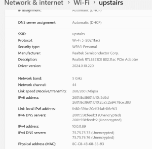

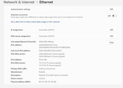

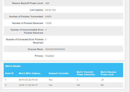

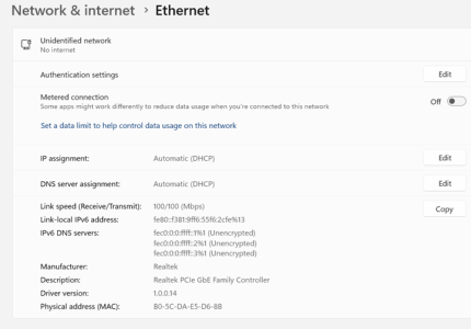

Here are the first four

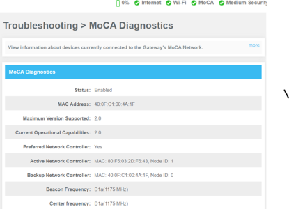

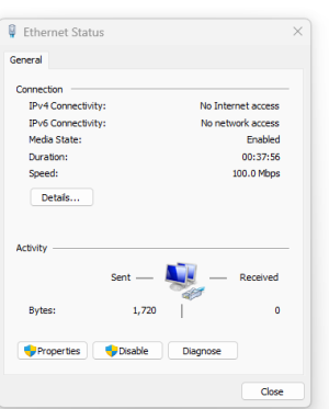

Here are the remainder.
I hope someone can determine why Moca is not active via my computers.

I noticed that when I got into the xfinity modem, the moca was listed as public while my wifi is listed as private.
That is shown on one of my pictures I sent. I don't know if that is the problem but it seems peculiar and there is no method to switch it to private.
I also noticed that in my settings, the internet status shows both IPv4 and IPv6 have no internet access.
