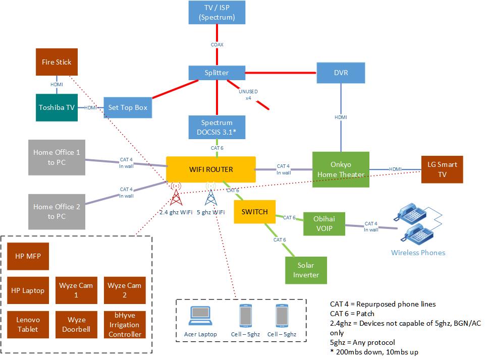

For those who've been following my saga on routers, I'd like to ask some questions. We had a network wiring consultant look at our setup today and he proposed considering using MOCA to get more throughput to our home offices and possibly our home theater. Our problem is that the in-wall wiring was basically CAT 5 (not 5e) and is essentially repurposed POTS telephone line. Also, some of the lines were (per the guy who originally converted the telephone lines to Ethernet) questionable in terms of quality and may have been stapled causing breakage.
Reviewing getting CAT 6 to our critical locations (two home offices plus home theater / media center) will be tough. The home theater may be doable (downstairs and could be accessible) but the location of the main can for cable coax and phone lines is at one end of the house (upstairs master BR) while the home offices are at the other end and there's no easy access via the attic to any of the existing drops. What we DO have is COAX going to each home office and the home theater. The COAX is occupied by a TV settop box in one home office and a DVR at the home theater.
I don't know a thing about MOCA compatibility with our Spectrum DOCSIS 3.1 modem but the relevant specs seem to be as follows:

Any thoughts are welcome! Note that I have to keep the 2.4 & 5 bands separate since our cams get confused if they share an SSID. Also, as it stands, I'm really not using anything on the 5ghz band except for cell phones & things that don't require 2.4. All the brown items are 2.4 only. Home Office 1 has the set top box, TV and Fire Stick.
