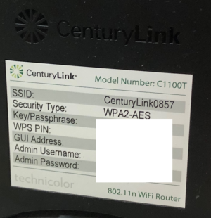

Thanks very much for responding. I think I "mis spoke" in that I have a router now and need a newer one. This one I have now allows me to do the stuff I want to do but not very good. I can't really see what websites are visited by my kids and the on and off of the wifi is not very good. I included a picture of my current router just for the heck of it. We live on 2.5 acres 325 feet by 325 feet and I also wish I could extend wifi to run cameras at the far end of the property. If you have a suggestion about that I sure would appreciate it. As I have gotten older I find technology more elusive. I need to try to keep up better. Thank you again. Have a nice day.
This is so called Home Gateway - Modem/Router/Wi-Fi in one device.
Cameras >300ft away are challenge. You can't do it by replacing the router alone. Some sort of long-range outdoor Access Point is needed for this with high-gain antennas. You also need power to the cameras as additional challenge and Wi-Fi connected cameras are low reliability. Someone with a RF jammer can take them out at once in seconds and from a distance. Your upload speed is perhaps too slow for remote monitoring as well. Longer distance from the hub 10Mbps xDSL lines usually have around 1Mbps upload speed or less. Any other ISP options around?
