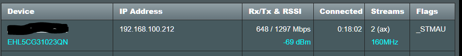

I have an RT-AX86S now running merlin 388 with cake QOS enabled. My internet is pretty good - 80/40 FTTC and stable on speed tests that I run regularly so I have cake configured with correct up/down settings.
I have my work laptop (brand new with 160MHz capable wifi card) but it likes to switch between the 5g and 2.4g band.
When I do the waveform buffer bloat test, I get A or A+ on 5g but consistently low scores (C's) at the same location when it's connected to 2.4g
A also find similar situation with my macbook (also new) but I have to force it to use 2.4 for testing as it prefers 5g as I would expect.
So my question is why am I getting such bad buffer bloat on 2.4g vs 5g? How can I trouble shoot this? Should I even care?

No. The extra latency is coming from 2.4GHz band Wi-Fi. It's added between your router and the clients because the band is heavily used on limited available channels and your router has to wait for air time to transmit data. Test bufferbloat with wired devices only, but in general don't care much about it because it occurs at line saturation speeds only and most online testers are not very accurate. Not accurate on Wi-Fi - extra variable in the equation. Your Cake QoS is good enough, but test your Internet experience with and without it enabled. Cake QoS is incompatible with Runner/Flow Cache (NAT acceleration) and you may find your network more responsive without it. If you have no real issues without QoS - don't try to solve non-existing problems. There is a chance you are only hurting yourself 95% of the time because of something possibly happening 5% of the time.
