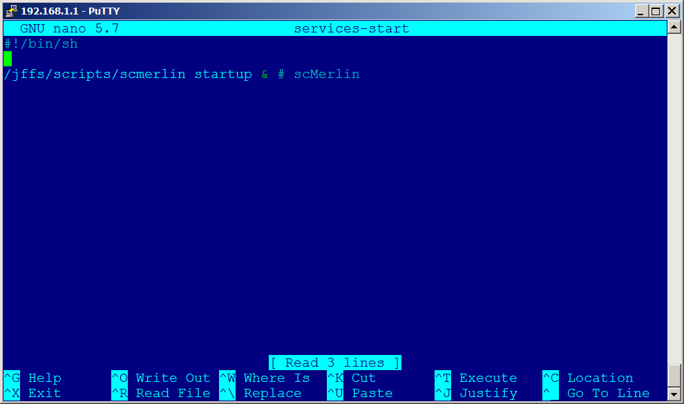

If I SSH into the router using Putty and enter the first command, it brings me to a screen with the following info:
GNU nano 5.5              /jffs/scripts/services-start              Modified
#!/bin/sh
/jffs/scripts/scmerlin startup & # scMerlin
| is the command line where I can actually type. That's the bottom of the screen. If I scroll up, a bunch of lines with /tmp/home/root# nano /jffs/scripts/services-start appear, with the very last one also having /jffs/scripts/services-start next to it.
Not sure what to do from here. :oops:
nano is a full screen editor, a bit like Windows Notepad. You should have a screen like this:
Use the arrow keys to move the cursor to the bottom line and enter your command. Then press Ctrl-O to save (Write Out) the file.
Press Ctrl-X to exit the editor.
EDIT: Fixed typo. It should have said Ctrl-O to save the file
Use the arrow keys to move the cursor to the bottom line and enter your command. Then press Ctrl-X to save (Write Out) the file.

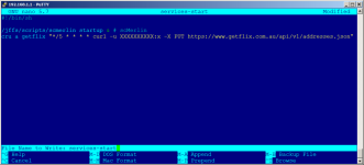

Thank you very much for the detailed instructions! I was finally able to set it up, thanks to you.
Now, it's just a matter of waiting for an IP refresh and making sure it works. :D
