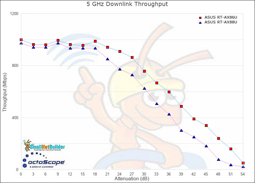

ASUS' RT-AX88U AX6000 Dual Band 802.11ax WiFi Router has been tested and added to SmallNetBuilder's Wi-Fi Router Charts. While it uses the same Broadcom four-stream 5 GHz radio SoC, the AX88U's throughput performance lags behind the less-expensive RT-AX86U. Check the Wi-Fi Router Charts for more details.
ASUS RT-AX866U vs. RT-AX88U 5 GHz RvR

@thiggins I notice that the latency scores are worse for the AX86U compared to the AX88U. Do you think that might account for the increased throughput of the AX86U?
Higher latency generally means lower throughput. The reason why the AX86U has higher throughput is its 2.5 GbE port. the AX88U's 1 GbE port is limiting throughput.
Yes, that's what I thought. For example, the 5 GHz Multiband Latency is 52 (19ms) for the AX86U and 73 (14ms) for the AX88U. I just wondered whether that might have some bearing on the 5 GHz Downlink difference you highlighted.
Ah, sorry for the confusion. I was referring to the wireless throughput/latency in the charts you linked to in post #1, not the router latency.
I *am* referring to wireless latency. I'm now running tests through the router WAN port because you can't swap the > 1 GbE port on some products (XT8 for example) between WAN and LAN.
So, the Wi-Fi latency measurements do include router latency, but that what users will experience anyway, unless their traffic is local.
I *am* referring to wireless latency. I'm now running tests through the router WAN port ...
Ah, I see. Thanks, that makes perfect sense now. I'm an idiot for not re-reading your testing procedure :oops:. Apologies for wasting your time.
Not a problem, Colin. The new benchmarks take some getting used to. It's always good to have fresh eyes on the results to keep me honest.
I had to go back and review the data to make sure I hadn't made a data entry mistake. It took me awhile before I realized that the difference was the Ethernet port speed. :)
