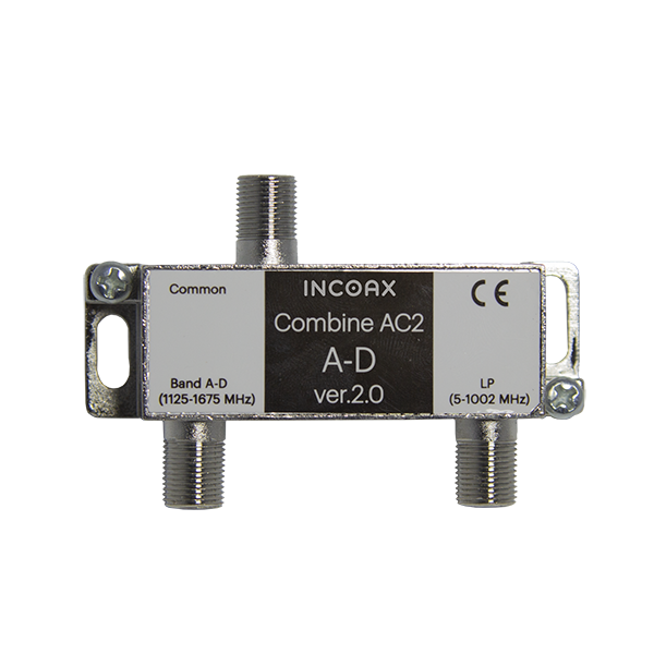

p.s. An elusive cable/MoCA diplexer:
The description of the setup lacks the details needed to make any specific recommendation (or suggest optimization alternatives), but if the secondary amp is actually required as described, you’d want it to be an amp designed to support MoCA to facilitate MoCA connectivity between output ports — and would potentially need a MoCA bypass setup akin to those described in section 3.7.1 of this MoCA Best Practices PDF. (like figure 10, but with the secondary amp in place of the downstream 2-way splitter)
Were such a thing available retail (see below), a MoCA/CATV diplexer would have been handy for the component fronting the secondary amp, to direct the MoCA and cable signals with minimized loss; barring that, a MoCA adapter with such a diplexer built-in could be used, but the preferred MoCA 2.5 adapters all lack this feature.
This diplexer seems to be discontinued. Have you seen any other MoCA diplexers available with the band splitting as above? Need these as my favorite MoCA adapter is no longer in production (Motorola MM1025)...
