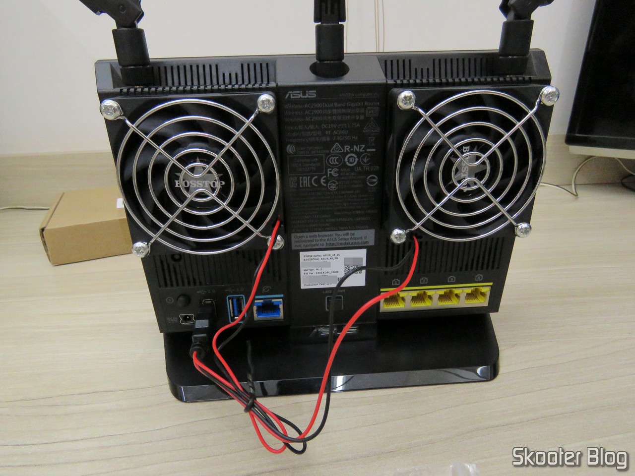

I'd assume a heat issue and proceed accordingly... keep it cooler... some apply a USB-powered case fan. Some open the router up and re-apply heat sink thermal paste.
Asuswrt-Merlin firmware reports actual CPU temps. Someone here may comment on SSH commands for retrieving same info from the router. If temps are off, it might be worth the trouble to redo the thermal paste.

The AC86U runs rather hot (too). Mine ran at CPU Temp = Tamb + 55 degrees Celsius idling.
There are external fans though, powered by one of its USB ports. Made one myself and managed to get CPU Temp to Tamb + 40 degrees Celsius.

those ac88 run damn hot compared to the ax88... I got a fan for it - knocked it down quite a bit... I'm happier now...
