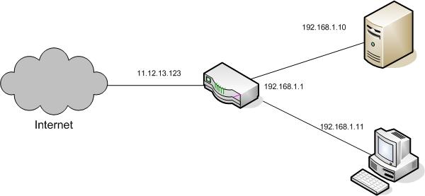

Regarding DNS - you have one public IP address, which is traslated into your home network through NAT. So you can have inside as many adresses as you want. These will be "grey" or private IP.
Like this:
If you want to get an remote access to devices in your network, you need translate corresponding ports of your devices to your external IP address. Like this:
PC 192.168.1.11 port 80 have to be translated to 11.12.13.123 port 1080
Server 192.168.10 port 80 have to be translated to 11.12.13.123 port 1081
If you want to use DNS you can use external address of you router. Register it on dyndns and instead of typing 11.12.13.123 you wil be typing something like this myhome.dyndns-home.com.
Every device in your network can be mapped to a single external IP address with almost any port. And you need to register on dyndns only one device - your router.
If I understand correctly what you want ^__^ And sorry if you already know all of what I have said.
