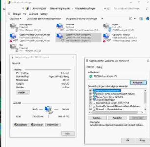

Is there any way I can keep the internet speed on the computer even when the vpn tunnel is active?
I enclose a picture which show the two open internet connection on my home computer (when openvpn is on).

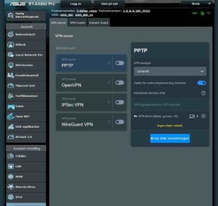

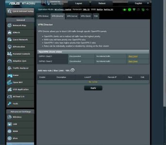

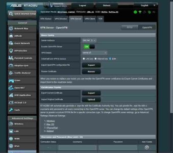

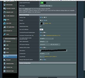

But must ask, do you mean that I change settings on the remote server (where the OpenVPN server is). I enclose a picture of the servers settings. What to change?
Can Samba on my new router cause the problem?

Basic OpenVPN configuration (not Advanced Settings) should have something like "Clients should use VPN to access" with 2 options "Local network only" and "Internet and local network".
I have a ROG router and my interface is different.
And yes, setting that needs changing is on the remote router.

The solution is near, thank you very, very much. I enclose picture of vpn general settings and there I have used "both". Changing it to "Lan only" is your advice?
I suppose such change need export of a new client1? (I have earlier exported both client1 and client2 files and can test on client2.

I'm not sure if that setting is actually presented in client.ovpn file. It should not, I mean...it's easy to be vpn server decision and client will just follow.
Client should only follow routes updated after the vpn session is established. So if default route (that's internet and it will include remote LAN) will be pushed by the VPN server, client will obey. But if only the remote LAN subnet is pushed, client will only learn that route through the VPN tunnel.

Fantastic, drabisan, you made my day."Lan only" work fine and now I have regained full internet speed even when the OpenVPN tunnel is on. I didn't need to change client1.
