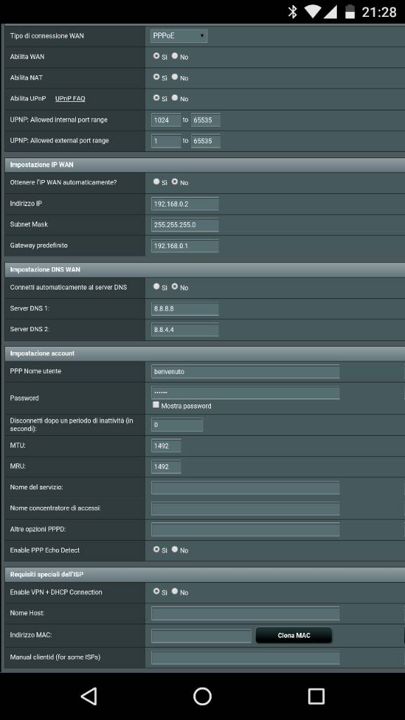

Hello Rmerlin,
my connection is pppoe. This is a screenshot of the configuration.
virtually all other settings are default (firewall, LAN, etc.)

Your configuration look weird to me. Why are you using a static IP that isn't routable? With PPPoE, you should normally set it to automatically obtain the WAN IP. Otherwise, it might confuse the router's routing.

I would remove that static IP configuration as it might be causing routing confusion.
I removed the configuration of static IP address, but the problem persists.
