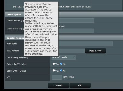

Not 100% sure if this is related but worth a shot to try and change the setting (if it’s in aggressive or continuous mode) to normal, to check:
Then of course there’s folks that have fixed it by replacing a cable to the modem or switching off the modem for a minute and switching it back on again…
Thank you. I was surprised how I missed that option. Turns out that it's not shown when I select PPPoE as WAN connection type.
