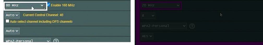

I Make Site Survey and it seems that using the 160MHz band is appropriate for my Location
That is not what determines fit for use.
