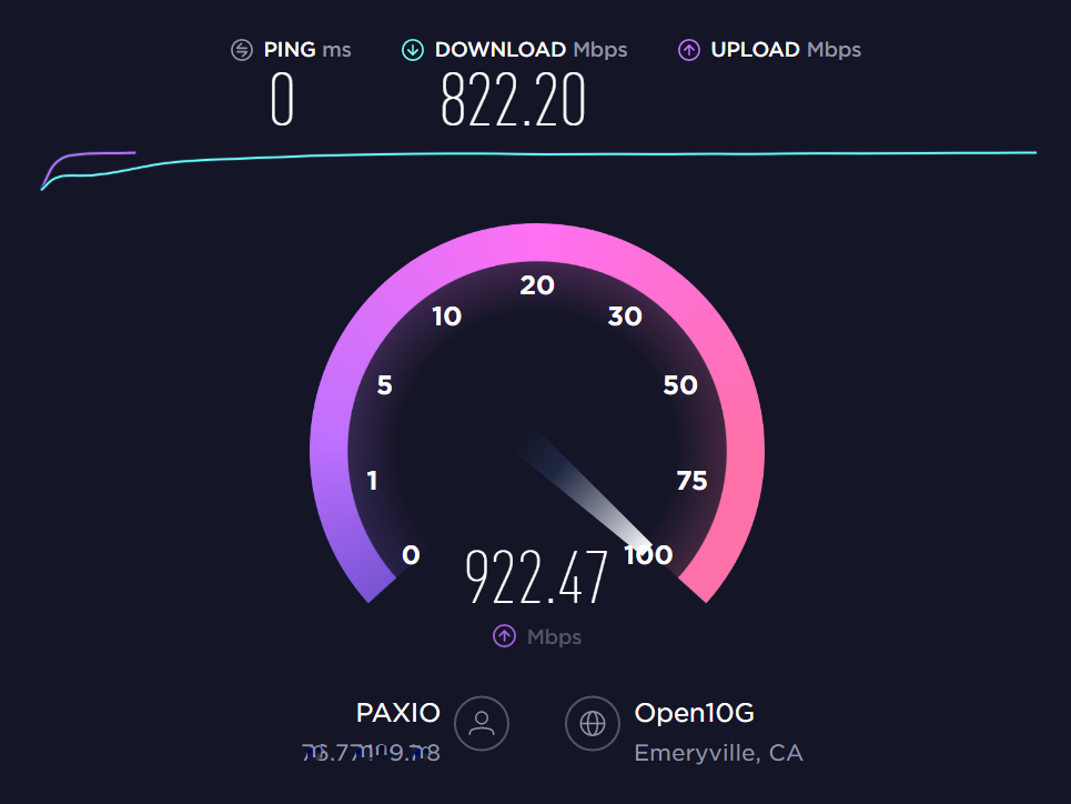

With that said, I have xfinity 1200/40 service with SB8600 (1Gb) with ac86u, two older netgear ac routers set as AP via wired backhaul, and 1gb infrastructure (switches). I get 941mbps to my 4 wired desktops. I have 5 people (two college students, one high school, and two adults and I work from home as an engineer. I got the gigabit service because I wanted the 35(40)Mb up because the next lower was 25. We have roughly 18 devices in the 2000sq ft house (main and basement each).
I upgraded from n66u in 2020 to an AC86u and the Motorola SB8600 and things are mostly well. However, I cannot take advantage of the over provisioned gigabit service. Xfinity with the SB8611 that I have been testing can do 1366 down wired and 885 down via an AX6000.
I am a prudent spender.....and I spent $765 to try my experiment......SB8611 with 2.5Gbps port to AX6000 with 2 ports. Internal 2.5Gb will go to a new TrendNet 2.5Gbps 16 hub for the 3 wired computers and then for one remote basement corner, I will put in the ac86u, and one for outside usage at a back window. I understand the loss of speed but pragmatic. AX6000 would cover the central house. Most of my wifi devices are ac wifi5. The AX6000 seems to provide 20-100% better download speed for the same distance on wifi5 devices.
Though with this investment, unless transferring large files, it does not seem this upgrade will make much of a real world noticable difference? Does this extra downspeed make much difference?
Any comments on this situation or considerations? Debating to keep 'my investment' or send the whole kit and kabootle back and wait 2-3 years for wifi7 and DOCSIS 4.0.
Thank you in advance for any advice. Peace.

Good points. Thank you both. My current MB8600 is a single gigabit wan port. No LACP possible. Thus the MB8611 for testing.
The 20-100% faster wifi speeds seem and the slight distance benefits of the AX6000 lean me that direction but I suppose if I replaced the primary router with an ax86u vs an gt-ax6000... why would I just replace the router for roughly $250-350 and not do the rest of the 2.5Gbps infrastructure.....but of course it will all be cheaper in the future but in how many years.....and the enjoyment across that time is worth something. I work from home all the time now......on Zoom & teams meetings, teams channels, Sharepoint drives, Onedrive, and sending many things via Outlook as well.
However.....941mbps versus 1366 is not really going to be noticable likey because both sides of servers need to come up to speed and use multiple streams......That is what Ookla speedtest uses.
A better router would deliver faster app updates to the 6 phones in my household but really so what.

Correct. You have invested in better speedtest numbers basically.
Right. That is what an older WSJ article says......it measured many streams and excess beyond 300Mbps does not make much difference.

You know....perhaps I invest in a used AX-86u and get better wifi numbers with wifi6 and forget the rest. Save me $600 and I get the better central wifi speeds for wifi 6 clients. Then all I am missing would be the difference between 941 and 1366 for 3 wired PCs and I really don't use that many times.
Though with the AX6000 and other infrastructure, I could deliver true 450Mbps to 3 computers simultaneously.
Hard time for me to justify just better speed test numbers.
I am not a torrenter at this point. The GT-AX6000 provides the ability to VPN specific IPs via the router for different services etc. Wow, that's fancy.
