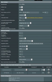

It seemed to start when I uprgraded to 380.66 which may well just be a coincidence. I have tried with UDP and TCP, hostnames and resloved hostname, port 443 and port 80 but nothing seems to fix it. I have also done a factory reset on it.
Current settings are as follows...
The router is a Asus RT-AC87U running 380.66_4 and the VPN is AirVPN.
Any help on this much is very much apreciated!

Try setting TLS renegotiation time to something like 3600 (1 hour).
I would also specify an explicit Hash digest instead of Default, and double check the TLS authentication to ensure it's really what it needs to be (this currently configured setting isn't very common with tunnels, so I'd double check that.)

Back online and 16 hours without any issues apart from a lot of replay packers from time to time. Hopefully fixed. Thanks for the help!
