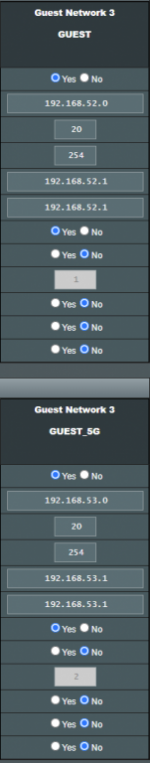

After installing YazFi on the RT-AX86U and setting the config as advised, I rebooted the repeater. After the reboot, it was still accessible through the DHCP assigned 192.168.22.76 address. Strange. I would have thought it should get something in the 192.168.53.x range.
I then tried setting the repeater IP via its LAN settings page to 192.168.53.1. Now it's not online at all.
Seems to be the same as result as when I used the 192.168.103.x subnet on guest index 1, but will need to check when I am back there in the morning.

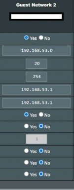

Okay, I 30-30-30 reset the RT-AC68U repeater and reconfigured it with a static IP address of 192.168.53.11 as part of the setup. I connected it to the GUEST_5G network. I still cannot access its web interface.
However, I can connect to the STUDIO SSIDs it is broadcasting, and they are assigning IPs in the 192.168.22.x range.
