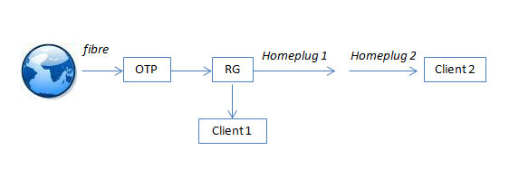

I'm currently using a pair of AV200 homeplugs to link my main desktop to the internet. I just got the house plugged into a fiber plan (100Mbs). I'm in the midst of building a WHS and wondering the order the server should be plugged into my LAN.
Ideally I'd do CAT5e but it's a no go... the missus won't have trunking running all over the house. Routing is a major pain as the house was built to be "bombproof" (if there is such a thing). Most of the walls are 2 feet thick reinforced concrete and the server will be placed in the bomb shelter which has even thicker walls and a 400lbs steel door.
Currently configuration is as follows...
http://i602.photobucket.com/albums/tt107/SG_Knife_Collector/Capture1.png
Total of 2 homeplugs and 2 clients. I'm planning to add a WHS and an HTPC into the network.
Questions...
  1. I'm going to add another 2 homeplugs; 1 for the server (in the bomb shelter) and another in our bedroom for the HTPC. I know homeplug AV200 can handle the extra pair but how should I pair them up? Should I pair all 4 together?

Moving to 500 Mbps powerline will provide more throughput. Check the Powerline Charts and reviews. 500 Mbps will provide both higher per-link and total throughput. You can put all the adapters on the same network.
Get a pair of 500 Mbps adapters and try them out. If you like them, I'd move all the adapters to 500 Mbps. 500 and 200Mbps HomePlug AV adapters will interoperate. But if both kinds of adapters are active simultaneously, the 200 Mbps pair will slow down the 500 Mbps pair.
