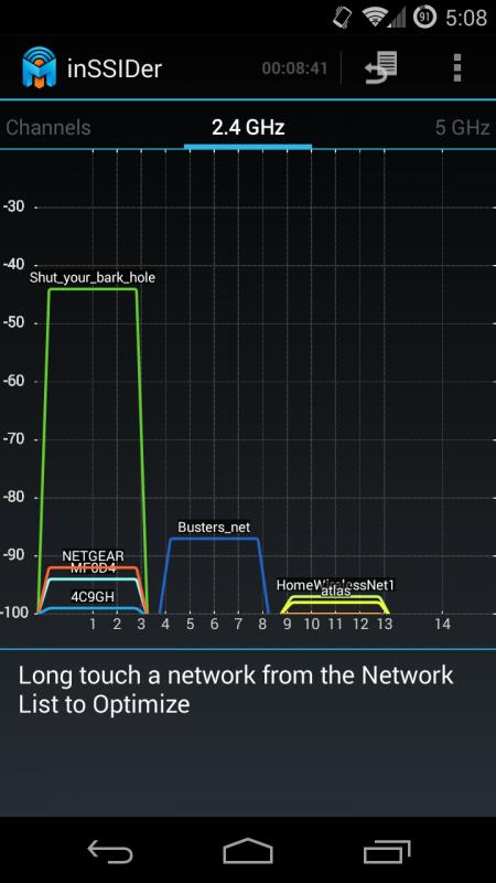

Attached is my situation... I think you can guess which is mine... Yesterday when I was playing around there was more people showing on channel 6. Maybe I need to make a switch...
The suggestions made previously helped out a huge amount. Increased the speed by about 15Mb/s measured from the same location!

Hey, glad you saw such a good improvement!
Just curious, did you try channels 6 and 11?
Just seems like inssider indicates that channel 11 will be the best channel.
The higher numbered channels are almost always the ones that work the best for me.

As of right now I'm looking at inssider and I have about 7 different AP's sitting on top of 11. Only 1 AP at 1. I'll play around with different channels and speed tests but from a congestion standpoint i think I'm at the best spot right now.
Still huge improvement!
The improvement is huge - but if it can be better simply by trying it, why not?
Curious what you find works best.
