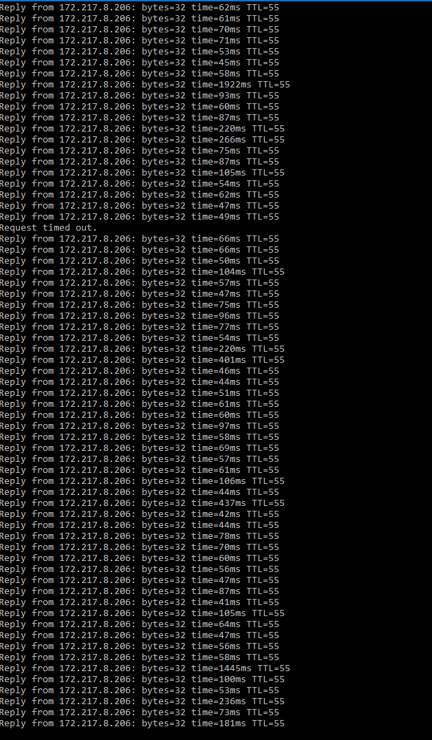

I have an AC68U and SB6183. I've tried every combination of QoS settings and even with extremely conservative bandwidth limits (even as low as 40 Mbps!) none of them seem to do anything. I start a download and ping times immediately jump from the ~20 ms range to 200 ms or much, much higher and stay there for the duration of the download. Even if I limit the speed through the program (like Steam or Origin for example) to less than half my max speed it still will spike quite frequently. I'm getting extremely frustrated and don't understand what I'm doing wrong. codel was working perfectly on my old router (N56U) and modem (SB6120) with OpenWRT, I bought the AC68U because despite the old router doing well with bufferbloat, it was severely limiting our download speed and I assumed the newer ASUS would perform better because I was under the impression that it has a faster CPU. Getting rid of bufferbloat is very important to me, as I live with two other people and we all enjoy downloading things and playing video games where ping is of the utmost importance.

edit: this is with 145/13.5, better than before but still leaves much to be desired. hurts my speed a lot as well. maybe i'm just asking too much of the hardware and i need something more powerful. also the speed climbs, ping stays kind of steady around 40-100 ms, then as it hits the limit/goes over it, huge ping spike and then the speed plummets back down rinse repeat. kind of annoying.

These issues look like the PUMA 6 issues
https://www.dslreports.com/shownews...-Puma-6-Chipset-Have-Some-Major-Issues-138411
Is the SB6183 puma based or boardcom.
I don't think you issue is the router at all. This looks to be ISP and modem problem with all that high spiking.
The 6120 you had is a 4/4 channel modem vs the SB6183 is 16/4 these type of issues are seen more on high channel modem's that is why you never noticed it on the older modem. And unfortunately you need the high channel modem for faster speeds.
Here are my results to the same ip
I'm using a Hitron CGN3ACSMR 24/8 modem on a 250/20 package and it is PUMA 6 however I have an updated firmware on my modem from Hitron to address the latency spikes.

ping between my pc and router is always <1 ms, ping between my pc and modem is <1 ms with low bandwidth usage, between <1 ms and 2 ms with high bandwidth usage.
