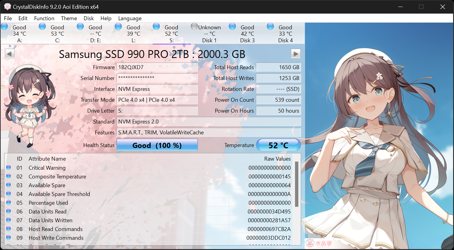

I don't know if it works with your router or not, but I know you have to keep this drive well ventilated and in upright position. WD markets the drive as 5400rpm class, but the actual drive inside is renamed Ultrastar HC300 series 7200prm and it runs very hot inside Elements enclosure. I have two of those purchased in 2020 and they run at 55C idle reaching 67C reading/writing large data. The drive inside is an excellent performer, but designed for data centers with proper cooling. Elements used to come with WD Red drives; now it comes with WD White drives. The label color is visible through the vents. If you see WD White check what's going on inside with this tool:
I use mine for NAS with active cooling. Both came with WD80EDAZ, aka Ultrastar 7.2K drives.

It is unlikely that the drives inside WD Elements are running at 7.2k rpm, most likely they are at the normal 5.4k rmp. However, it is likely you got air-filled drives instead of the helium filled ones which causes higher temps. In the past, WD was putting helium filled drives into externals from 8tb and up but these days, it appears that only 12tb and up have helium, anything less is likely to be air-filled and run hot. In any case, active cooling is easy with a USB-powered fan ;) I always stick one to an external while it's in use (in horizontal position - air is blown in at one end and comes out at the other).
