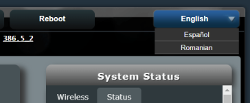

hello mi name is bogdan , I would like when I enter the page of my local router that it be the only language and also in the System Log section a button to deactivate activity log I want to delete all files of other languages, for example Chinese language I do not want it and other languages I would like to keep 3 languages English of all life Spanish and Romanian these I want in my language of my router it is necessary to modify the complete file of languages the others to eliminate them although it would not be bad to select the languages that you want to download for your router when you enter it would be the same if it were a new firmware, so a little occupied space would be released and it would load faster due to power outage and then it turns on faster as it only has 3 languages that I would like to keep, but of course I should contact the programmers and I don't know how to do it, someone help me Does anyone know that my firmware is RT-AX56U_386 beta 2 and as I said I want to eliminate all the translated files of the package that weighs 77mb maybe if it is delete the languages would be in 70mb or less is as if you formatted a new pc a single language but there I could leave English Spanish and Romanian delete the rest of all bases that included the system for a correct operation I hope that some programmer writes to me and once done said for my router upload it to www.mega.nz and send me the link or a free download site at full speed I hope you help me thanks guys

Removing the extra languages will not make the router "load faster" or "turn on faster" as the firmware is stored in ROM. The currently selected language file is only read when you log into the GUI. The other language files are not read.

ok but there is no way to remove translated files from the system GUI even if they are 5kb per language as there are 22 languages that I do not need, it would release 150kb from the system and not load or saturate the ram and the other problem of SYSTEM LOG there is no way to deactivate them since I am not interested in what my router does and writes everything down..

The language files are stored in ROM. They do not "saturate the ram".
You could create a custom script with Merlin's firmware that loaded a reduced language menu:
# egrep "LANG_EN|LANG_ES|LANG_RO" /www/Lang_Hdr.txt >/jffs/Lang_Hdr.txt
# mount -o bind /jffs/Lang_Hdr.txt /www/Lang_Hdr.txt

No negative effect on RAM use. This is pointless.
