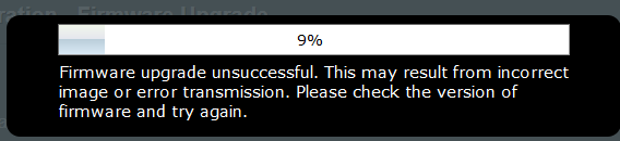

I wanted to upgrade RT-AX58U upgrade with RT-AX58U_3004_388.4_0_puresqubi.w but getting error
and then a message: Firmware upgrade is done. Please reboot RT-AX58U manually.
After rebooting I still see the old firmware.
How to properly upgrade RT-AX58U from stock firmware to Asus Merlin?

I have a couple of these and had this issue, it's a strange model where the current firmware has to be a certain version to perform the upgrade or change over to Merlin. I think it is 3.0.0.4.386.45898 - https://dlcdnets.asus.com/pub/ASUS/wireless/RT-AX58U/FW_RT_AX58U_300438645898.zip?model=RT-AX58U
agh! wish I knew it before ;(
I switched from ax56u to a58u
will need to send it back and get another router. Need Merlin onboard ;-)
Yes, the V1 is supported but not the V2.
