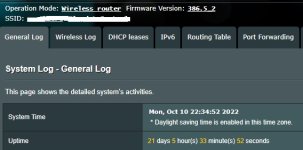

Just a follow-up.
After around 5 or 6 days, I plugged the USB drive back in & turned the media server back on.
Ran fine for a week. Then I went away. Got back a few days ago & just checked the system uptime. Over 21 days no reboots. See attached
So something in 386.7_2 (or perhaps even in 386.7 - didn't downgrade to that) was causing my issue - 386.5_2 appears to be rock-solid.
