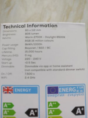

Ok, forgive me if i sound stupid, the bulbs are TCP smart bulb, 2.4 GHz freq. They just flash and flash and flash and will not pair to the network. But if i put my old Netgear r7800 router in place and try to pair to the bulbs, everything works fine. Its just this Asus router wont let me pair my smart bulbs..

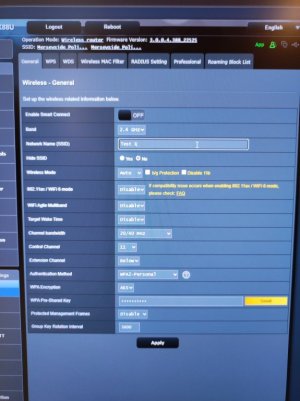

Hi, could you please provide a screenshot of how you have configured the 2.4ghz network in your router?

I use wpa2 (aes), simple password and i dont change much in the firmware. I will connect the router again later and take pics. To be honest ive given up with it and its sitting in the box, my ngetgear r7800 is connected right now. Tomorrow i will take some pics and post them up :) Please bare in mind ive turned off AX, gone back to AC, turned off the 5ghz frq wireless, ive done what i know and the smart bulbs will not pair ( bought new bulb, wont pair ). Yet my good old r7800 pairs bulbs, works everything ,the thing is bullet proof, but its old, i want to use my new rt-ax88u router :(
Sounds like you've been toggling options on/off at random. Some/all of those options don't allow the router to act the same as not toggling them on/off in the first place. Your router is not in a good/known state.
I suggest fully resetting the router, then doing a minimal and manual configuration to secure the router and connect to your ISP.
Change options slowly, and carefully (unless you want to reset and start again), and reboot the router before testing it too.
I would not suggest changing the options you've indicated. Leave things at defaults after the reset and come back and ask for further guidance if necessary instead.

Ok, i have uploaded a few pictures. MY network is very stable and i have no problems using the bulbs. Its only when i try to introduce a new bulb onto my network that the new bulb will not connect... Can anyone see anything wrong with my settings ? Thx
I forgot to add, yes, my mobile phone is on the 2.4 GHz band also. Like i say my old router, everything works fine and i can introduce a new bulb. This rt-ax88u router will not allow a new bulb to be added.... Obviously i have missed a setting somewhere. Silly question but how do i diable channels 12 and 13. :)
In wireless settings. Though if you already have some tcp devices connected this could prove irrelevant. Just answering that question
